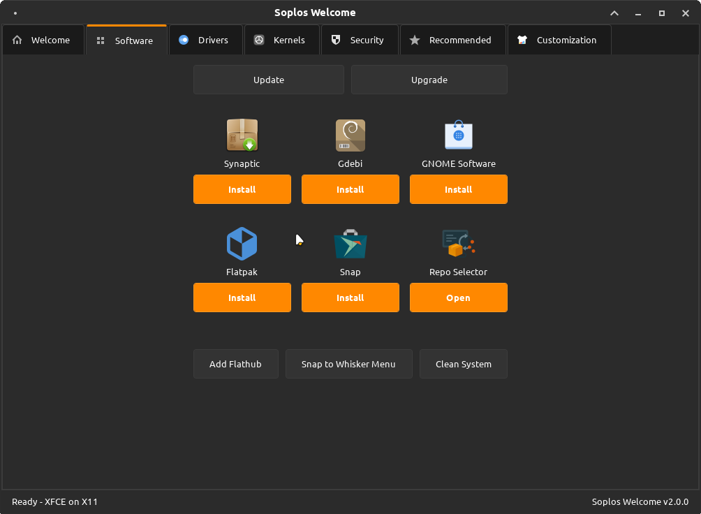

Graphical Method: Soplos Welcome
The easiest way to update your system is through the Soplos Welcome tool, which comes pre-installed on all editions (Tyron, Tyson, and Boro).
Soplos Welcome - Software Tab
Soplos Welcome Software tab showing Update and Upgrade buttons
  • Open Soplos Welcome from the applications menu.
  • Go to the Software tab.
  • You will find two main buttons at the top:
    • Update Repositories: Refreshes the list of available packages (equivalent to apt update).
    • Upgrade All: Installs all available updates for your system and applications (equivalent to apt upgrade).
  • Click "Update Repositories" first and wait for it to finish.
  • Then click "Upgrade All" to apply the changes.
Note: You will be asked for your administrator (root/sudo) password to perform these actions.
